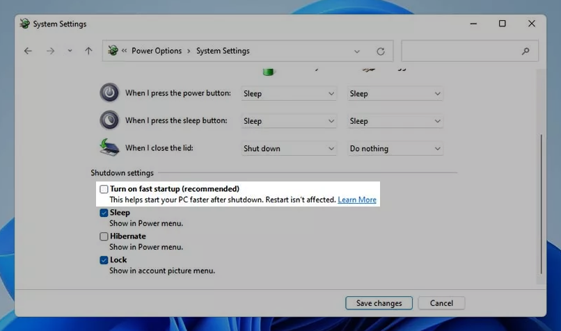

Disable Fast Startup and Fast Boot
You can solve some installation-related issues on many modern computers (produced after 2011) by disabling the Fast Startup and Fast Boot features. These features are designed for Windows-only computers, and disabling them shouldn’t affect the performance of Zorin OS.
If you don’t have Windows installed on your computer, you can skip to step 9 below:
- Restart your computer to Windows.
- Open the Search tool in the taskbar.
- Type “Control Panel” and open the Control Panel app.
- Navigate to “System and Security” → “Power Options”.
- In the left sidebar, click on “Choose what the power buttons do”.
- Click on the “Change settings that are currently unavailable” link.
- Under the Shutdown settings section, click on the “Turn on fast startup” checkbox to disable it (if it’s not disabled already).
- Click on the “Save changes” button at the bottom of the window.
- Switch off the computer. Make sure it’s completely powered off, and not in sleep or hibernate mode.
